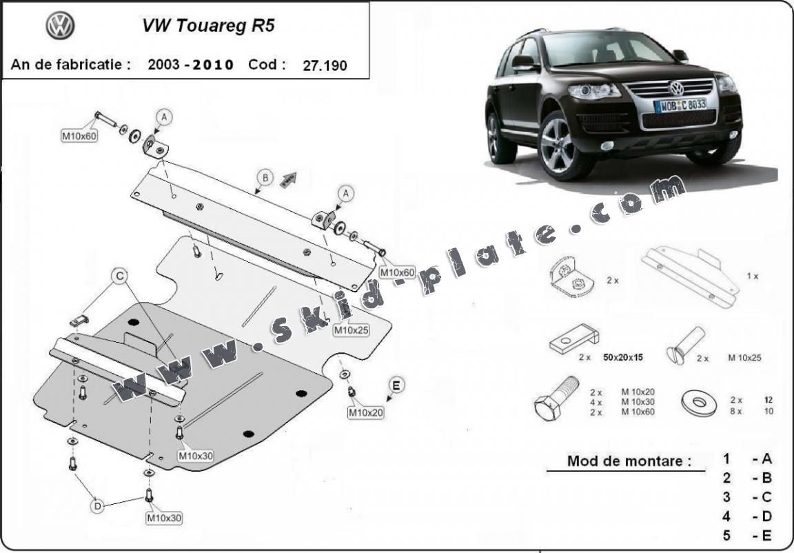

I've made a skid plate based on this design. SkidPLate. It is only held in place by 3 bolts and fully rests on the engine cradle. I've made mine out of a 1/4 aluminium plate. I have access to an AL welder with argon so I fabbed everything myself.
Take a gander at this website, maybe you'll see something you like StellSkidPlates
