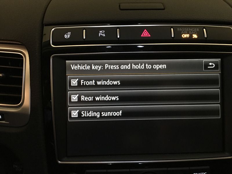

46-Central Conv - Comfort Operation, Key Warning, Remote Key Coding, Open-Close Adaptation codes
[Coding - 07] -> Long Coding Helper -> Byte 9 Bit 7 Enable/Disable Key Warning chime
Comfort Opening/Closing
[Coding - 07] -> Long Coding Helper -> Byte 2 Bit 0 Enable/Disable Comfort Operation. It must be Enabled (unchecked) for the adaptation codes to work.
[Adaptation 10] -> Select/adjust entries from the drop-down menu to configure the keys and various comfort opening/closing options. VCDS has help menus with each configuration’s code.

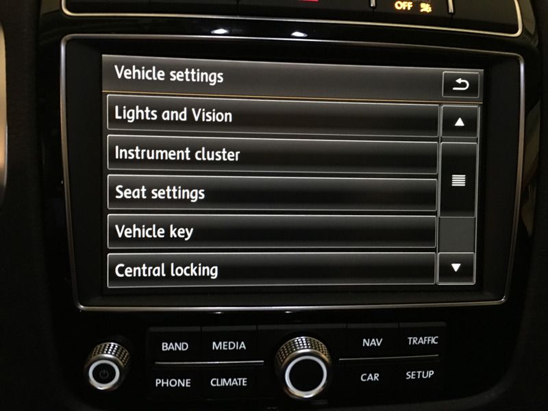

13 Posts
Comfort opening/closing windows/sunroof with remote. Nice to open her up on a hot day before you arrive to drive off .... or to close her up from office window (I'm 20 ft away) if it starts to rain.
No clue as to closing with rain sensor.
What is comfort opening?
Also, does this vehicle close windows if the rain sensor is wet?
Is this option enabled already? Sounds like it is from what I've been reading? If so, I haven't been able to figure it out.
