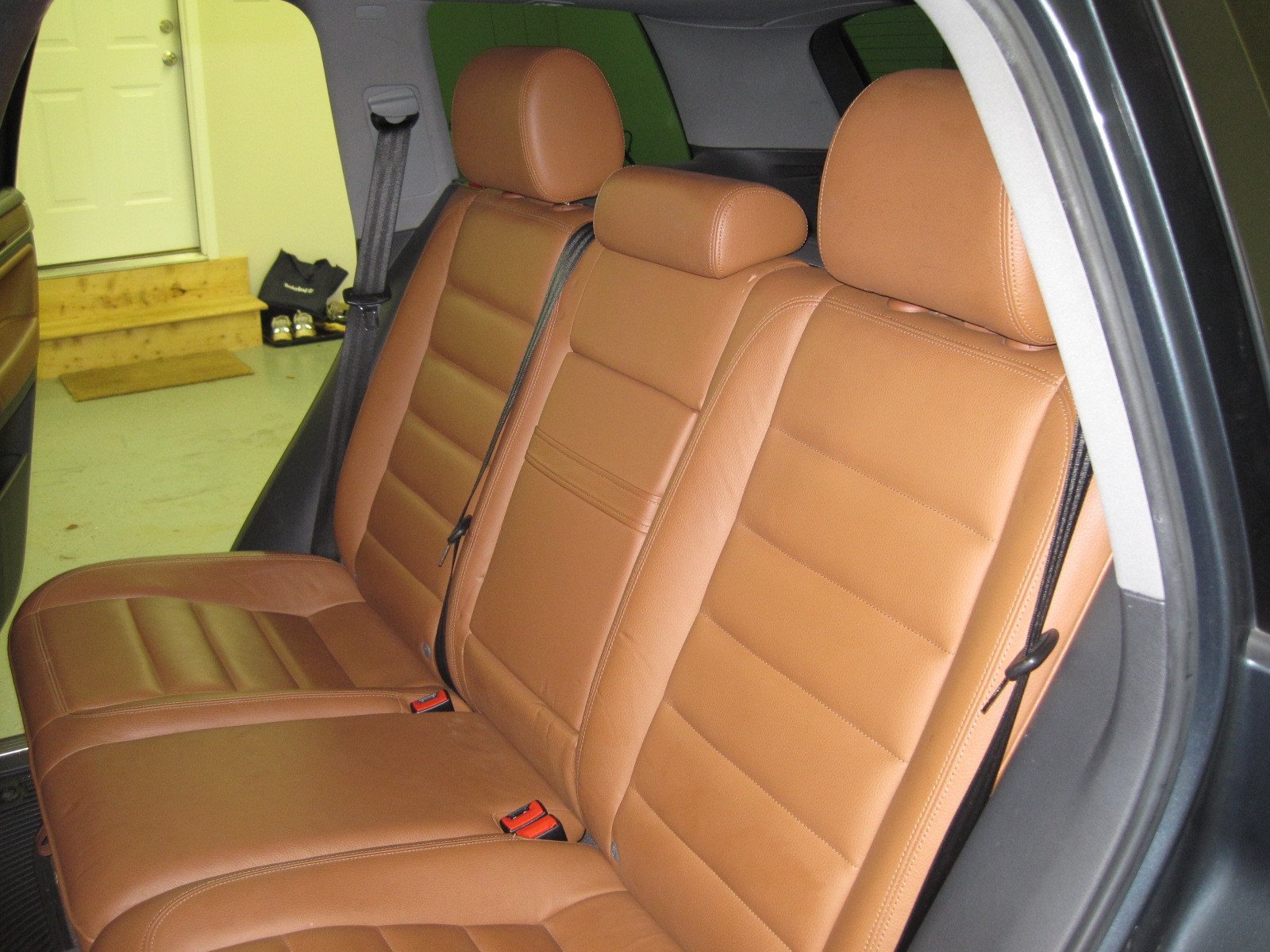

If it was my vehicle, I would unplug the fuel pumps at the connectors under the rear seats. If new fuses do not blow with the pumps unplugged, then it more evidence that the problem is in the fuel tank.

@nickyt thanks so much, you have given me a great place to start. Hopefully its just the pumps and I can swap them out. Need to get those seat belt connectors out in the morning so I can get to those pumps.
