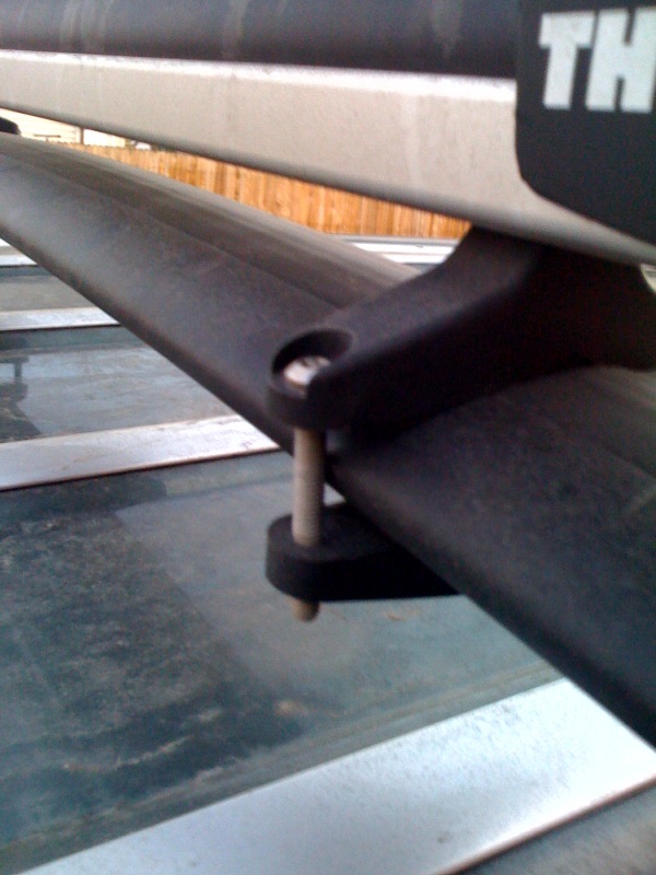

Sorry these took so long and that the quality is less than ideal. Quick phone-snaps on my way to the office.
I hope you can get the idea of the longer bolts extending the reach of the standard mounting equipment.

This helps, cause I have to get a new set of clamps/feet as well. Besides the bolts, I just wanted to see if the feet actually fit over the bars.

Yep, if you're going to a Thule dealer anyway you can just get their larger-size mounting kit. I ended up losing some screws so that's how I ended up on the trip to the hardware store. Good luck!
